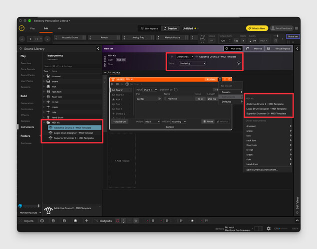

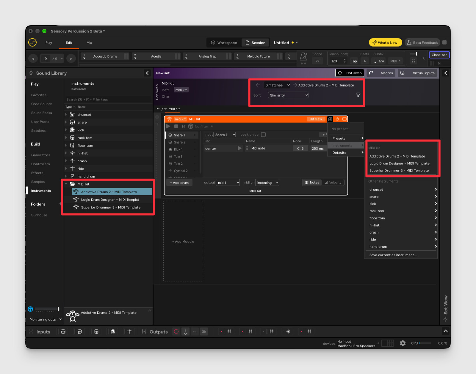

Looks amazing. Looking forward to testing. Quick heads up - when I try and open the presets menu you mention in the new MIDI kit module there are no presets showing up.
@MNDMTH the different midi kit presets are actually tagged as “Instruments,” so that they show up in the library. There’s a new “MIDI kit” folder in the Instruments pane. If you load a blank MIDI Kit module, you can access them from the Preset button under the Instruments folder.

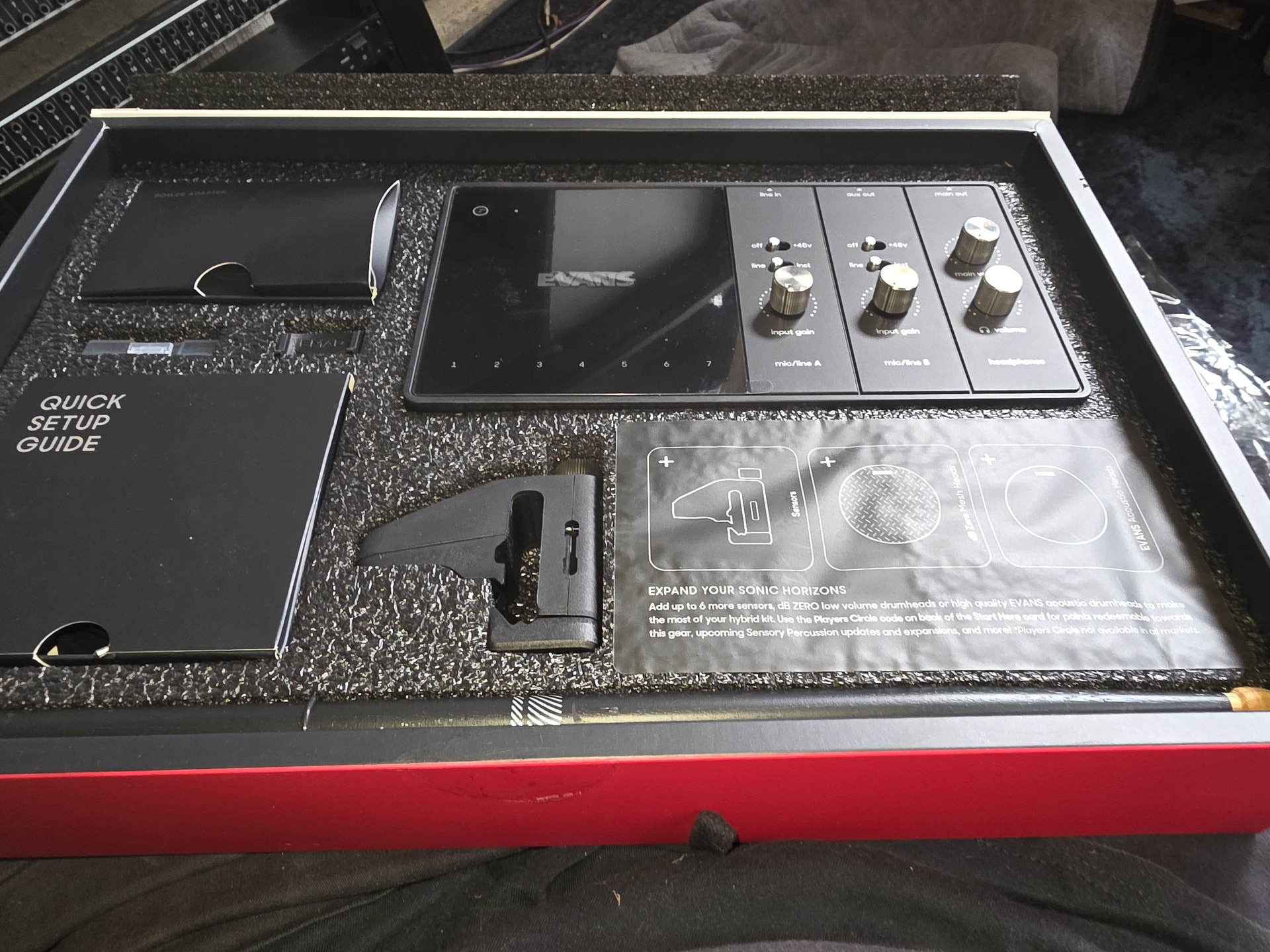

ok so here’s is my new second interface, just arrived today!
I have 2 additional drum and one cymbal sensor to run with it.
any tips?
@Dakota_Stone shoot us an email at support@sunhou.se and we’ll add you to the beta program. Thanks!
