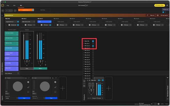

I downloaded the Beta and made 2x attempts, however, I am not hearing any sound. See attached picture. It seems the sensors are sending signal to the portal, but nothing is coming out. I am able to get sound when I open from the NON Beta newest update. No issues there. One other thing I noticed, not sure if it matters. In the Beta, I’m the when pressing the new arm button “R.” The entire Mix comes up, it doesn’t seem this button can be activated at all, as it’s one with the Mix dropdown(see 2nd picture). Thanks, hope it’s not just me messing up. I/we all appreciate the beta and support
hi @West_Brad thanks for the feedback! Are you still not getting any audio? And just to be clear, do you mean no audio in the recording file our no audio coming out of your speakers?
The R in the hardware input is not clickable – we’re going to change that to make it more clear. If you want to arm different mixes, use the dropdown under the record button to the left (you can see a 0 in your screenshot, which means you have no mixes armed) or go to the mix page on the global set.

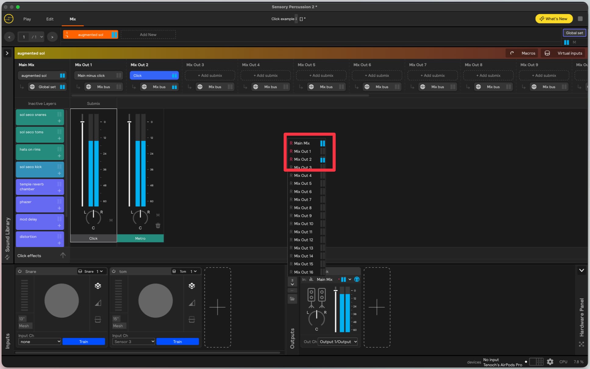

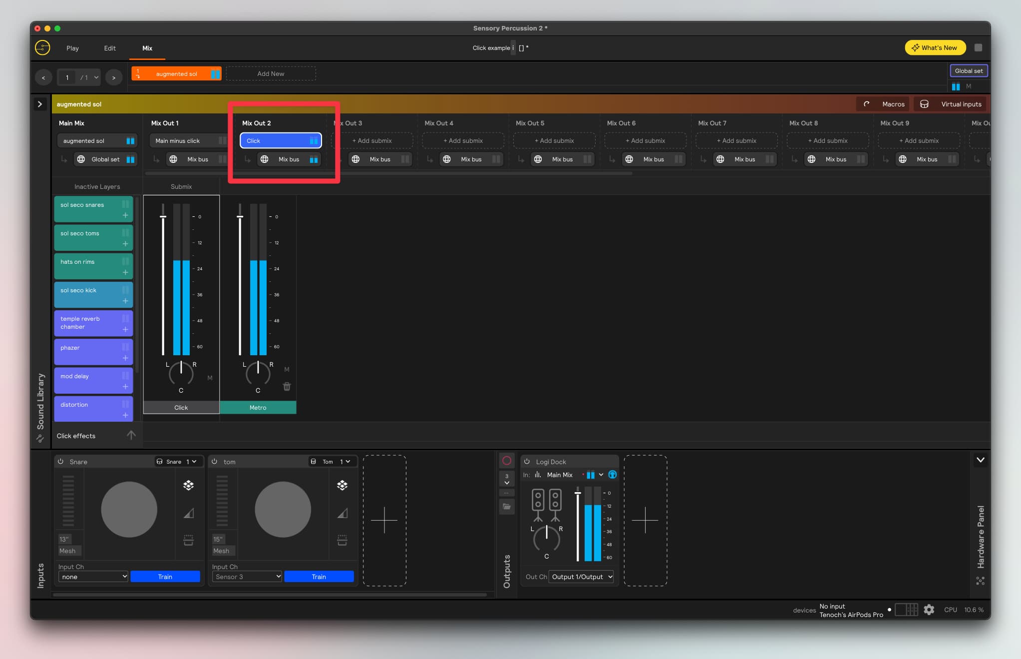

You can add a click track and record it separately using submixes. The only thing to keep in mind is that the Main Mix will always include the click track, so you’ll need to create a separate mix for everything minus the click.
We’re thinking of ways to make this a bit more “built-in” and seamless, but here’s a walkthrough of how you’d do this using one of the presets. I deleted all the default mixes to keep it simple:

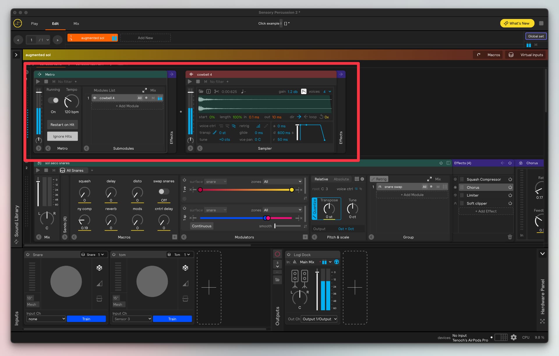

1 Make a click track by adding a metro controller and putting a sample in it:

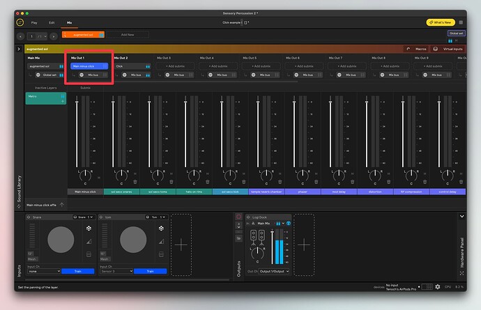

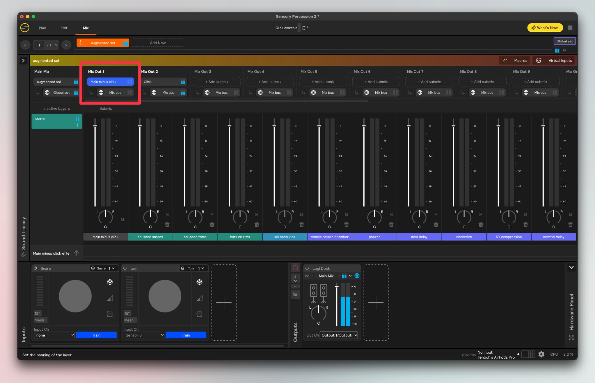

2 Make a new Main Mix submix by adding all the layers except for the click track

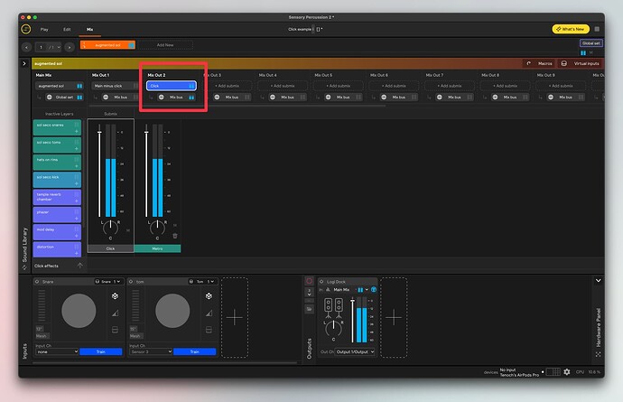

3 Make a submix for the click track
4 Record enable the new submixes so they’ll get recorded separately
Here’s the SP2 file if you want to check that out.
click record.sp2 (596.5 KB)
Let me know if you have any questions!
