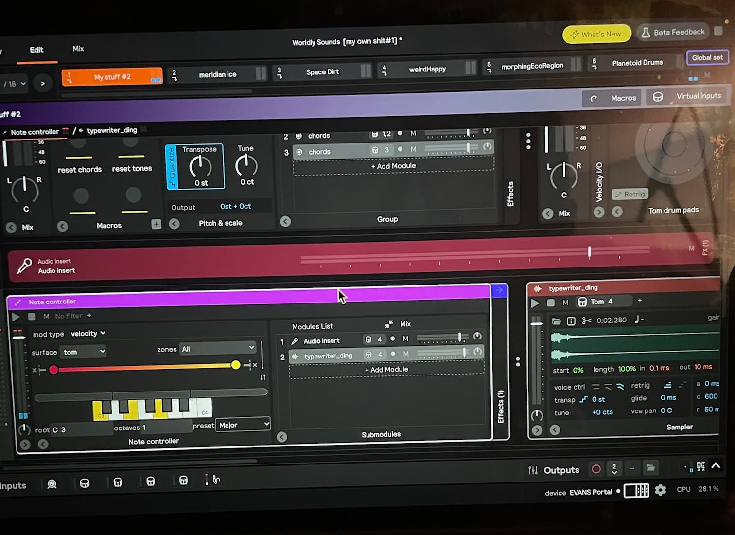

I’m attempting to use a Roland PDX-6 pad. Is it possible to trigger a sample from Sensory Percussion? I have a screenshot for reference. I am using an Audio Insert and the pad IS working, I can add Effects, like Reverb for ex. However, I haven’t figured out how to use the pad to trigger a sample from the SP library.

I used a pad from my alesis e kit. Plugged in with an instrument cable.If you add it as a sensor in the program it works.
That worked! Thanks man. So silly, that was the only thing I didn’t try. I was thinking it wouldn’t work, since it’s not an SP sensor
