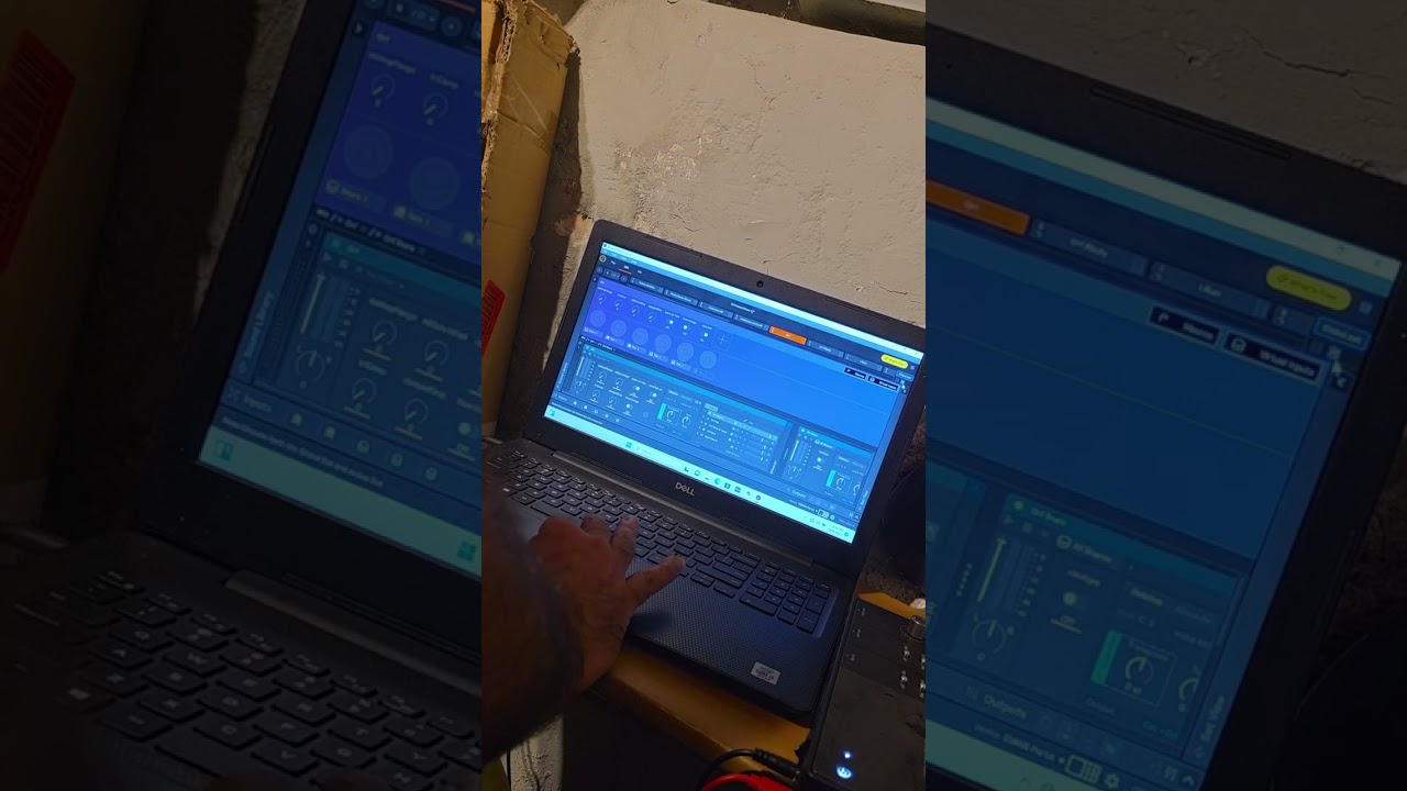

Can't find modules in 2.5?
What am I doing wrong?
