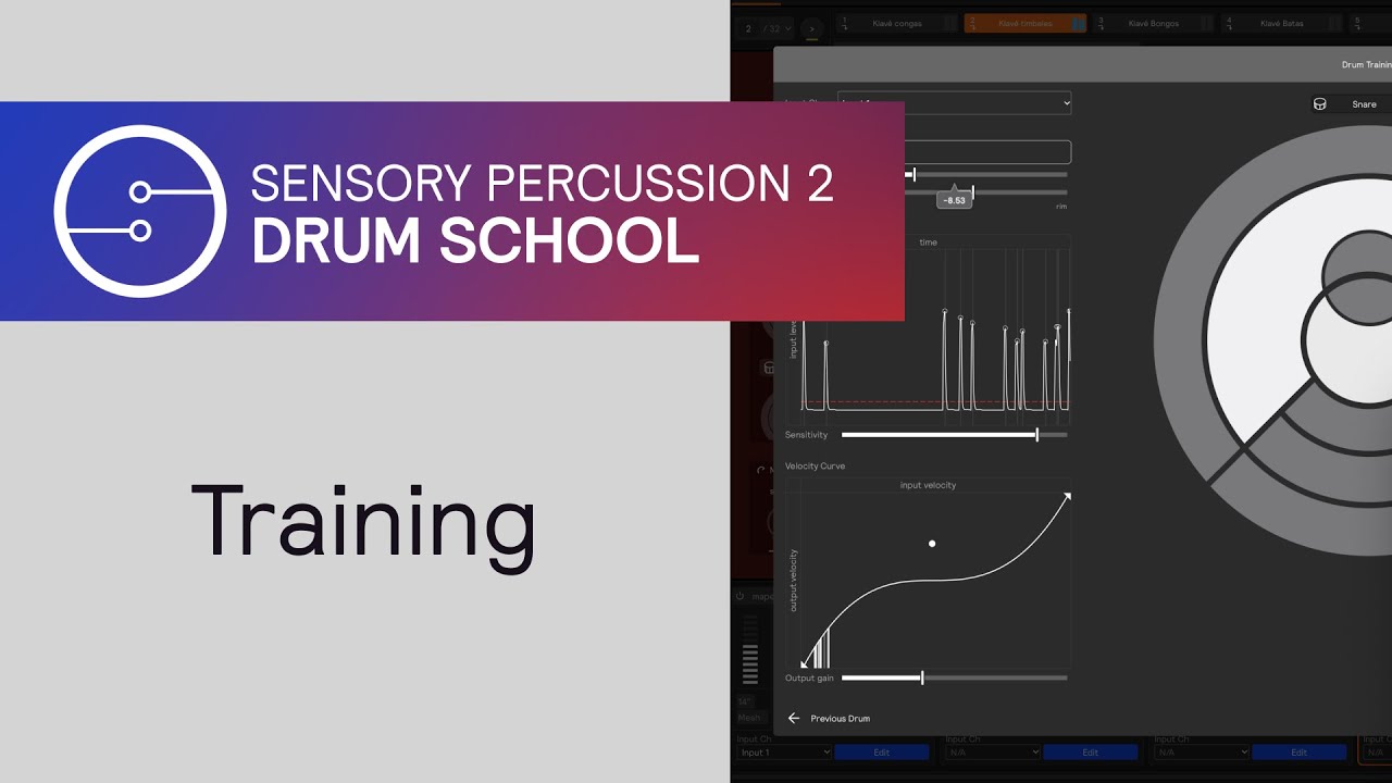

Hi @slackerheadtube - that is usually a training issue, but could be something else! I’d recommend taking a look at this video for tips on training:
If that doesn’t help, generate a diagnostic report and send it to support@sunhou.se and we can help look into what might be going on.
