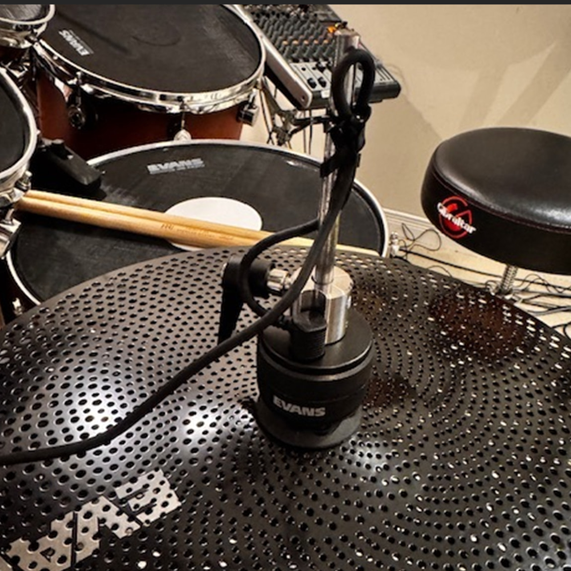

Did your cable slip in the flex holder over time, and start to pull on the jack? This was an issue for me. Even a small a mount of tension caused some false hits because the hardware is so sensitive. here’s how I fixed it:
ideally cable connection should be from the bottom.
Yes that was also one of my issues! I used some plumbing hardware to reinforce the gooseneck but this is an even sleeker fix. Love it.
