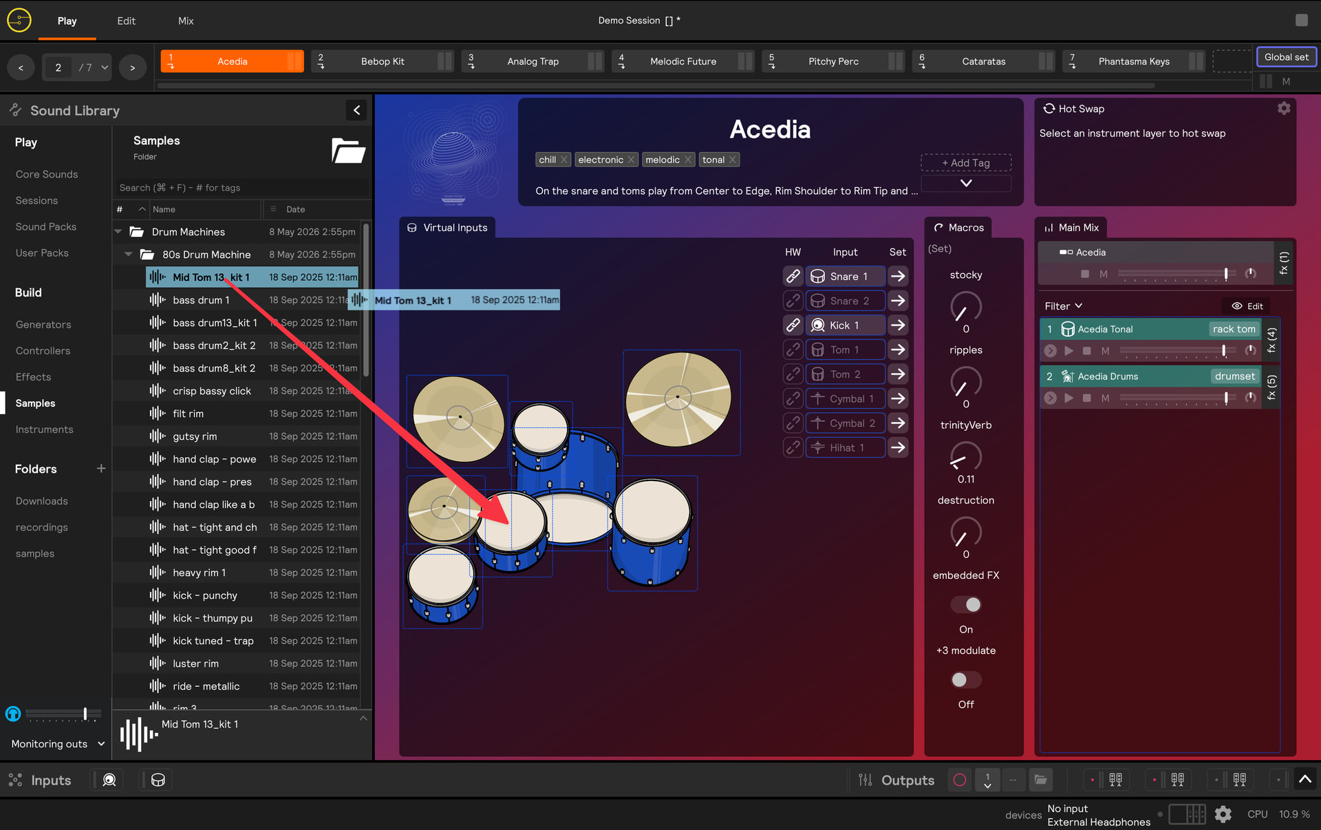

Hi @lisabeeen ,
We just posted a “Getting Started” tutorial video that might help you with some of your questions.
Around the 10:26 mark, it shows how you can drag a sample from the library and drop it onto a drum pad controller to assign it to that drum. You can also drag samples directly onto the drumset graphic in the play view to achieve the same thing (screenshot below).
