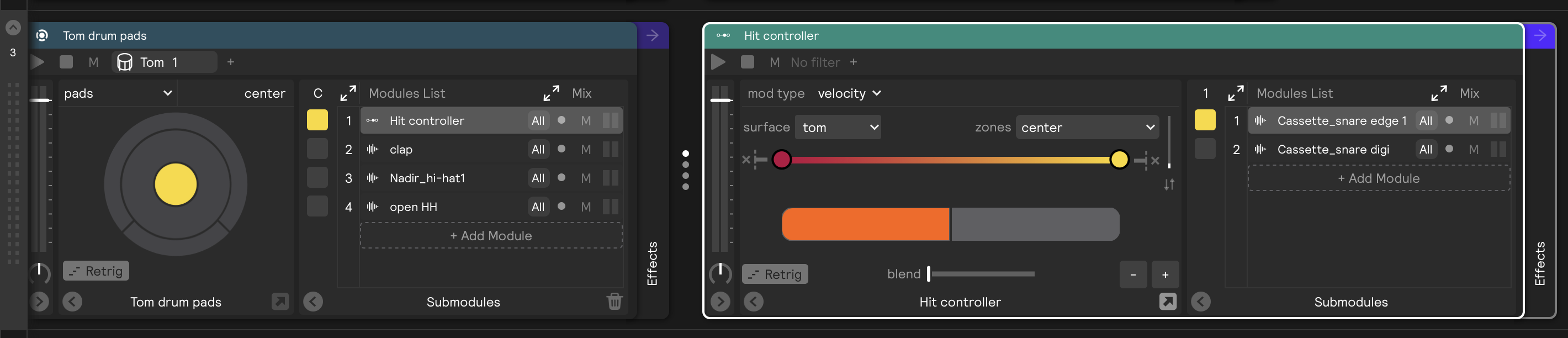

hi! i’ve been trying to use the hit controller without success- i only get to hear one of the samples when hitting the drums, no matter the velocity.

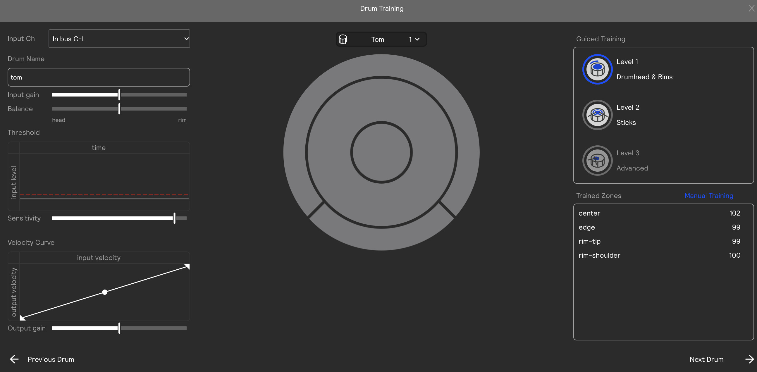

I’m attaching a screenshot, because i’m clearly missing smth out… tried changing the input level gate, nothing changed,

Hi @axelino,
The setup in your screenshots looks good to me, can you send an email to support@sunhou.se with a video of you hitting the drum from quiet to loud and showing the scale of your hits coming into the software? It would be good to see a video of both of the screenshots you sent - with you playing from quiet to loud - so we can see if the software is receiving the full velocity scale of your playing. That will better help us troubleshoot where it could be going wrong.
