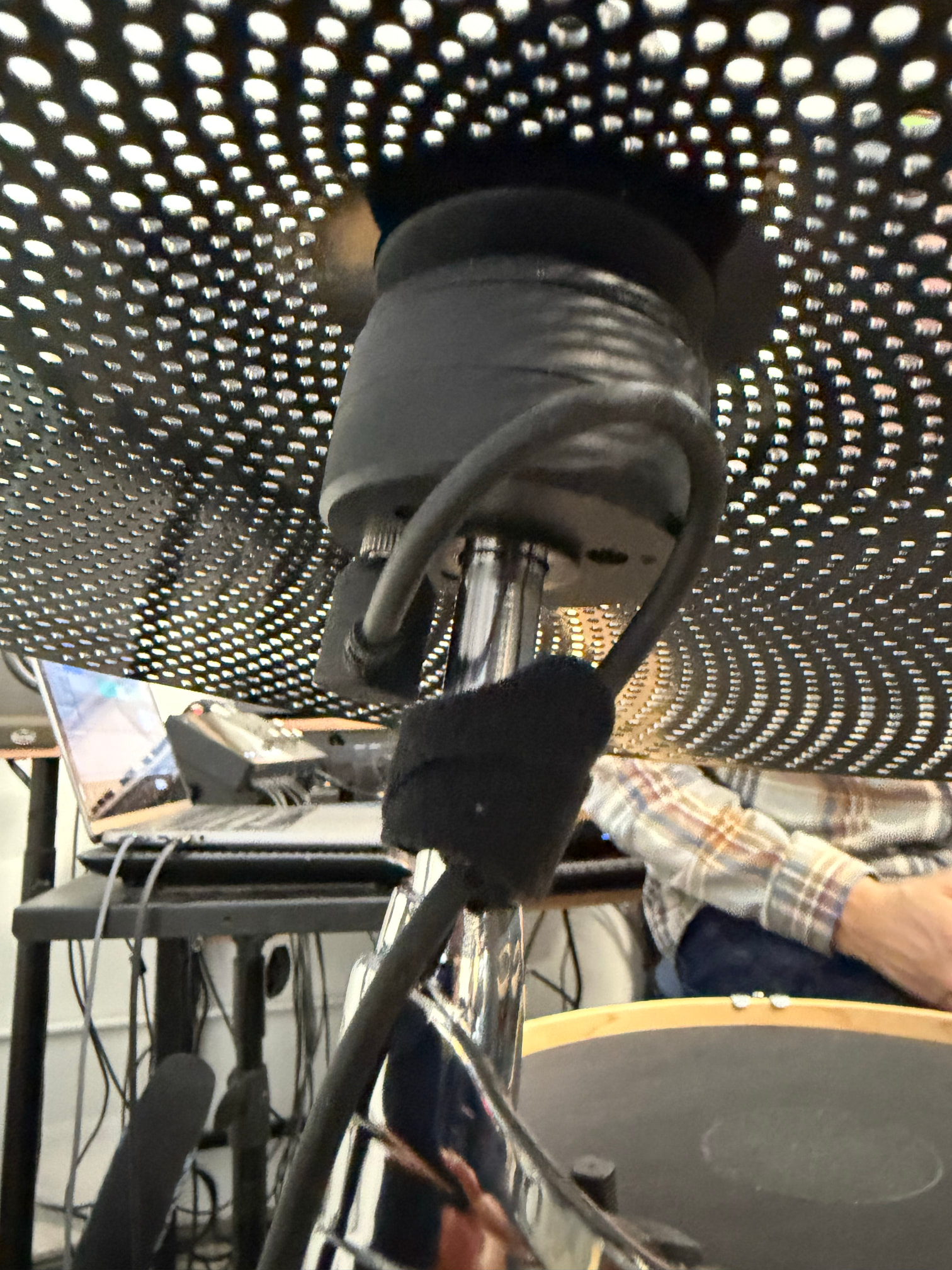

Hey all, the cymbal sensor should have come with some velcro ties in the box. In the Sunhouse studio we attach them to the stand like this and haven’t had any issues. Leave some slack at the top of the cable and then velcro it to the stand. Let me know if this helps.
Soo I did as you suggested and was still experiencing issues with the cables. I ended up using tape to secure them.

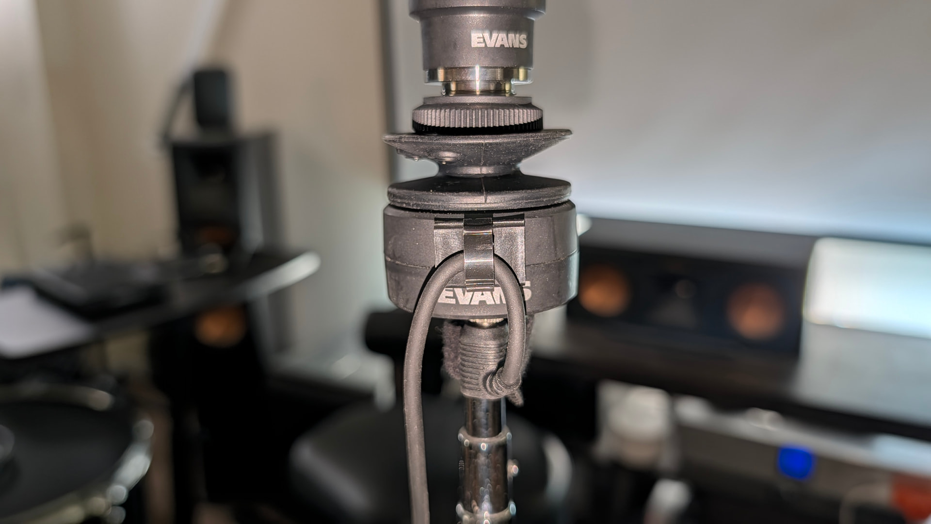

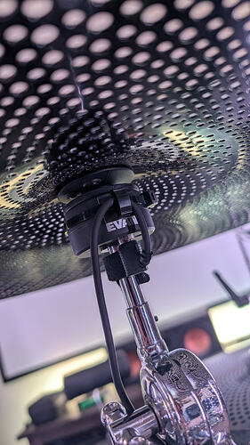

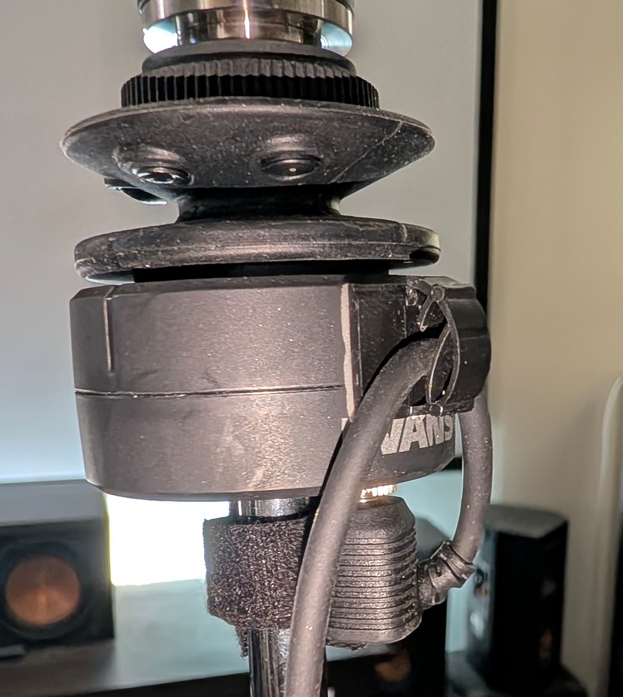

IF ANYONE HAS ISSUES WITH THE TRS CABLE UNDOING ITSELF FROM THE CYMBAL SENSORS, HERE’S YOUR SOLUTION:
Tonight I used the cable management clips, and they worked flawlessly. No issues after two hours of use, and the cable connection stayed in place to the sensor. Because the flat adhesive side of the clip couldn’t make full contact with the rounded sensor, I took a dremel to cut a bending point so the adhesive side could stick to the sensor. Once I was happy with that, to secure the clip, I used a ziptie that wraps around the whole sensor (look at the last photo).
