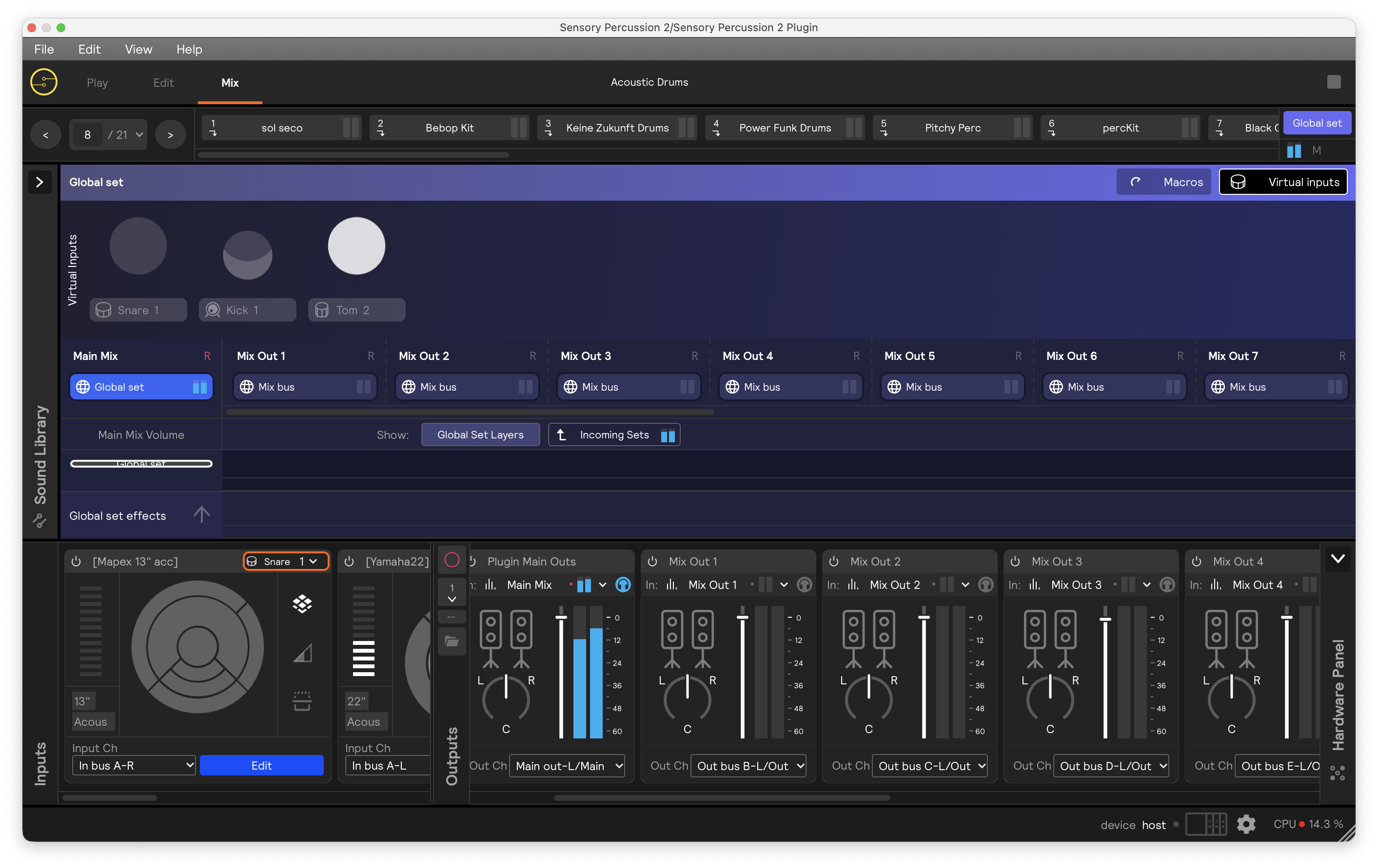

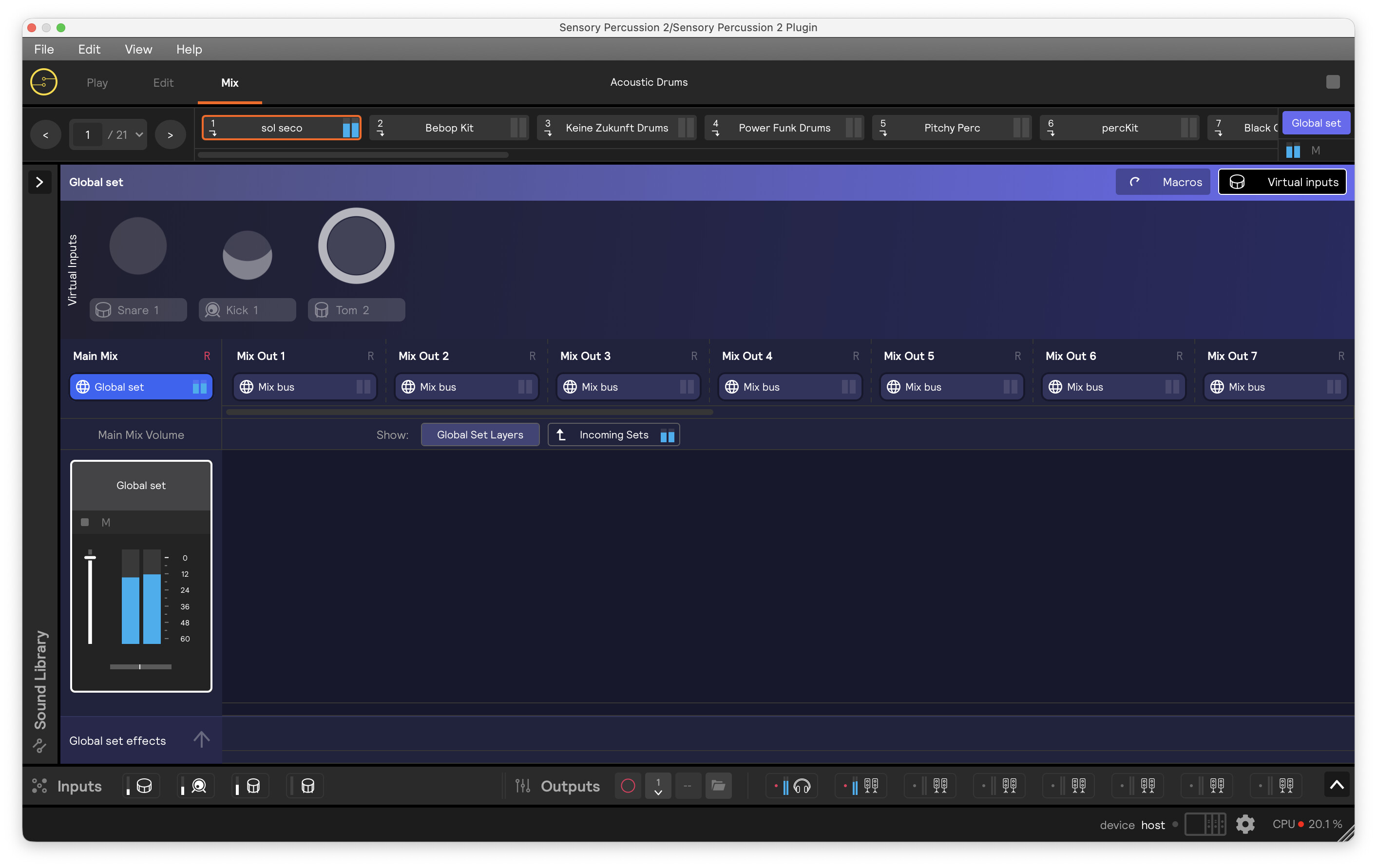

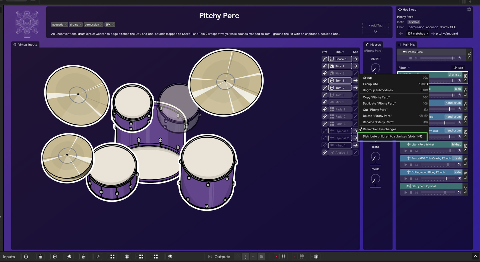

Hello! I’m having a problem with the plugin. Only the master bus is playing. Individual channels aren’t working; they’re not receiving a signal. Only a stereo mix is ​​being sent to the main bus. Please tell me how to solve this! I followed the instructions in the video.
Hey everybody! I have the same issue. The output routing of the template doesnt work - everyting is sent to the main out. There are no submixes in the sets… Would be amazing if somebody could help with that!
Hi @DomF,

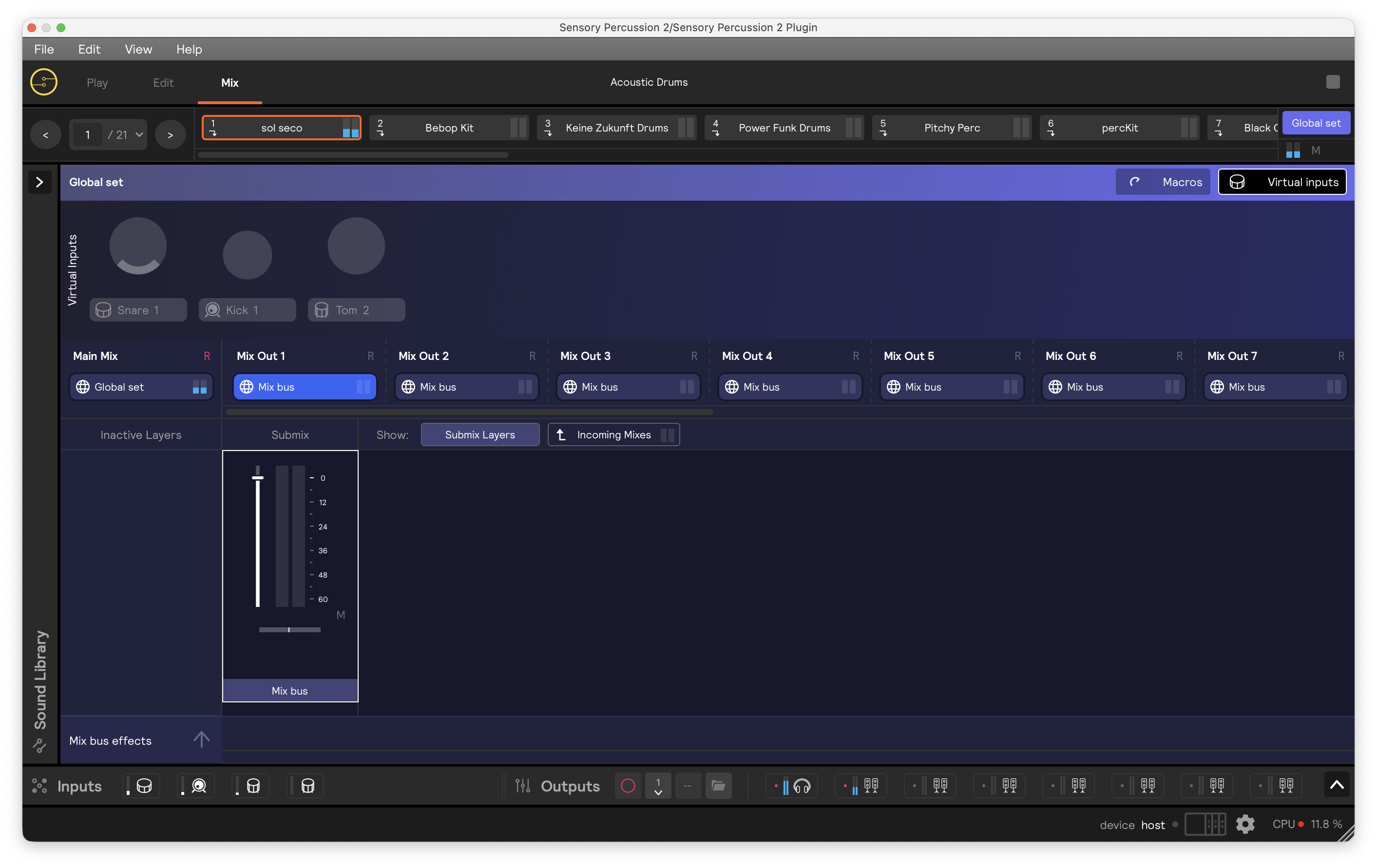

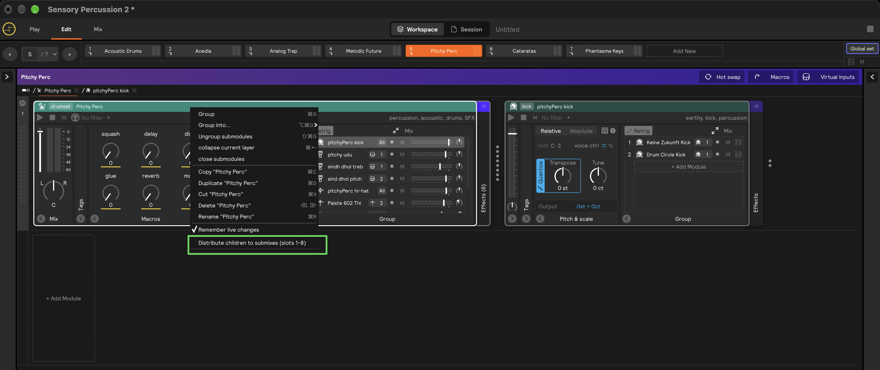

The quickest way to create submixes is to right click on the top layer in either Play view or Edit view and select “distribute children to submixes”

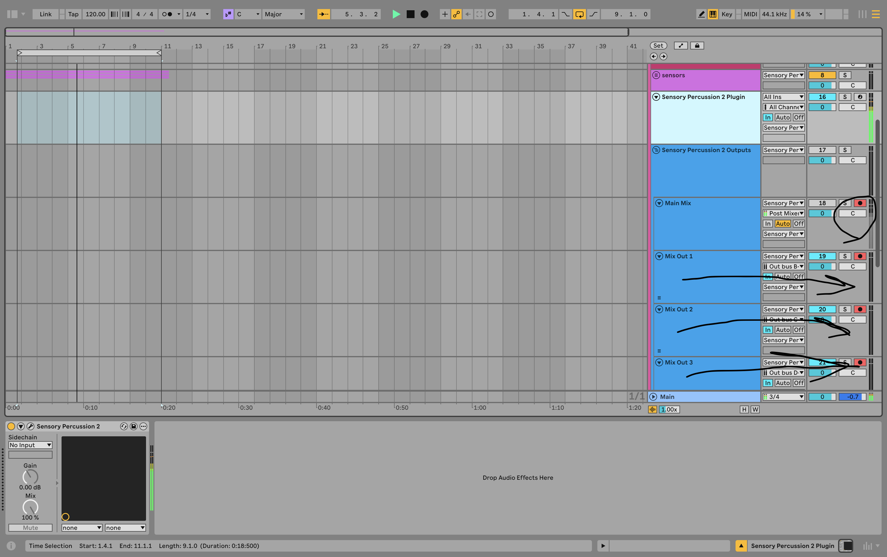

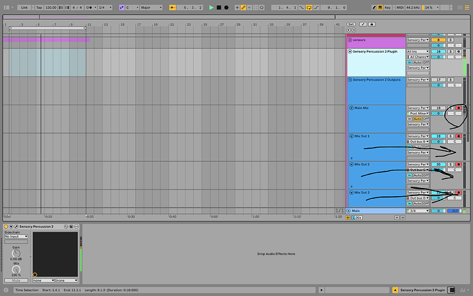

Then, if you’re using the plugin template, you’ll just need to record enable (arm) the channels in Ableton and record them.
