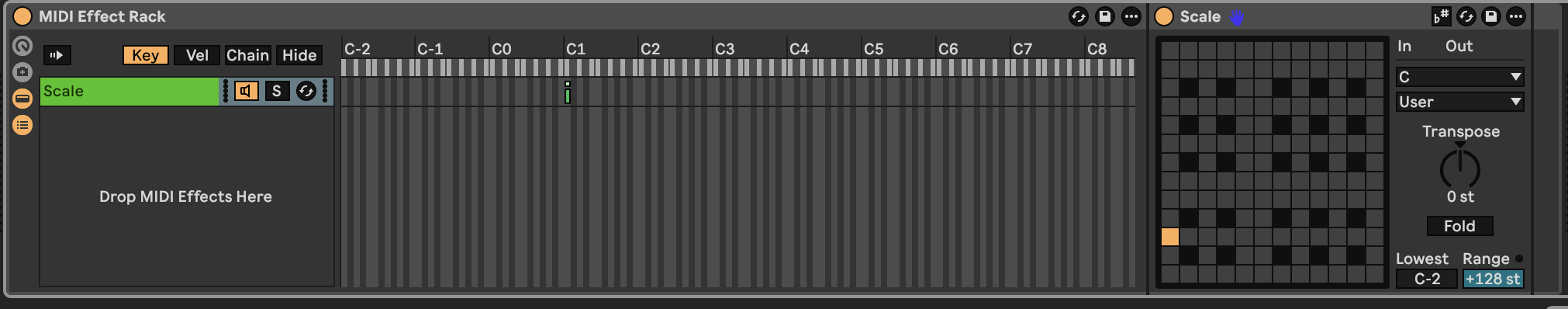

The easiest way to do this is just to set up unique MIDI notes for each zone of each drum and then filter and repitch these notes on a track by track basis in Ableton. So, for example if your snare centre zone is sending C1 but you want it to play D1 in Ableton, then on the Ableton track you are using filter out all other notes except C1 (using a MIDI rack) and then repitch the note to the desired pitch using either the Pitch device or the Scale device. Here’s how the MIDI rack would look with the scale device:
Thanks! I’ll give this a try.
It worked perfectly! Thanks MNDMTH.
