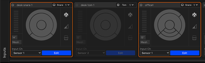

Thanks for writing in. I think the most likely cause for this to happen is that the sequencer is receiving two or more simultaneous hits from your hardware inputs. Since you have two setups, this is likely to occur if you don’t bypass your unused Hardware inputs when you switch setups. This has happened to me before, because I have multiple setups. I sometimes forget and do something like this:
Wherein desk snare 1 and office 1 have the same input badge and the same input channel, and therefore will be sending double hit messages to any modules that are filtered by Snare 1 or All Snares.

Thanks so much for your quick and helpful response. That completely solved the issue!
I had been experimenting with various toms and inputs, and most recently, I cut up three old Tamburo shells, modified them, and turned them into six shells for Sensory Percussion. By the end, I had a ton of inputs. Even though I had deactivated most of them, there were still a few active ones that I hadn’t noticed. Your suggestion was a great reminder to clean things up a bit.
