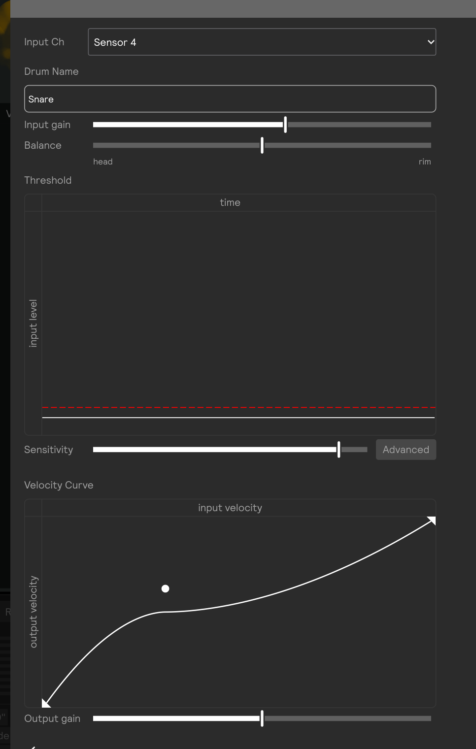

  1. increase input gain

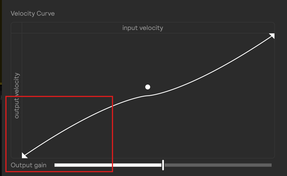

  2. increase output gain
  3. increase sensitivity
  4. set every kind of velocity curve type there is in variety of ways
Still, something is missing. And mostly, it just seems to trigger the drums too quiet

Some tweaks that really helped me:
  1. increased input gain and playes more with the velocity curve

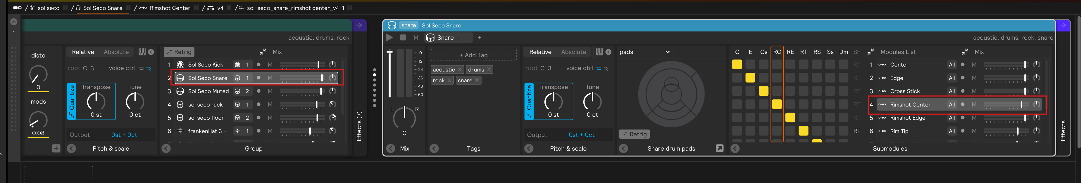

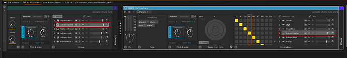

  2. Played with the volumes of the kit itself to re-balance it, especially the snare parts. increased a bit the center and reduced the rim shot which was way above the rest in the mix (for Sol Seco)
