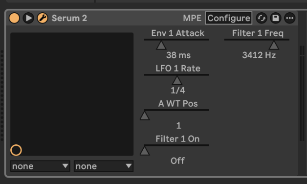

I imagine hosting VSTs that act like effects might be somewhat straightforward and would make sense inside of either of a layer or set-level fx panel in Sensory Percussion, but other instrument VSTs act more like generator modules, so we’d probably need to make a distinction between the two kinds and have a different interface for each. And then some VSTs, like ours for example, have their own set of audio inputs + outputs, so what happens you load the Sensory Percussion VST inside of the standalone Sensory Percussion app? A lot to think through!
While we don’t have news on this specific fx-related front, we do have multiple new in-house fx in the works, a couple of which are pretty close to being finished and added to Sensory Percussion 2 Beta. So keep an eye out for that!
And like @Joris_Hoogsteder mentioned, you can get a lot of mileage out of mapping MIDI from Sensory Percussion to parameters inside of 3rd party VSTs, but it does require having a DAW open. In Ableton, adding parameters to this “configure” window and then mapping CC knobs from Sensory Percussion is super fun.
