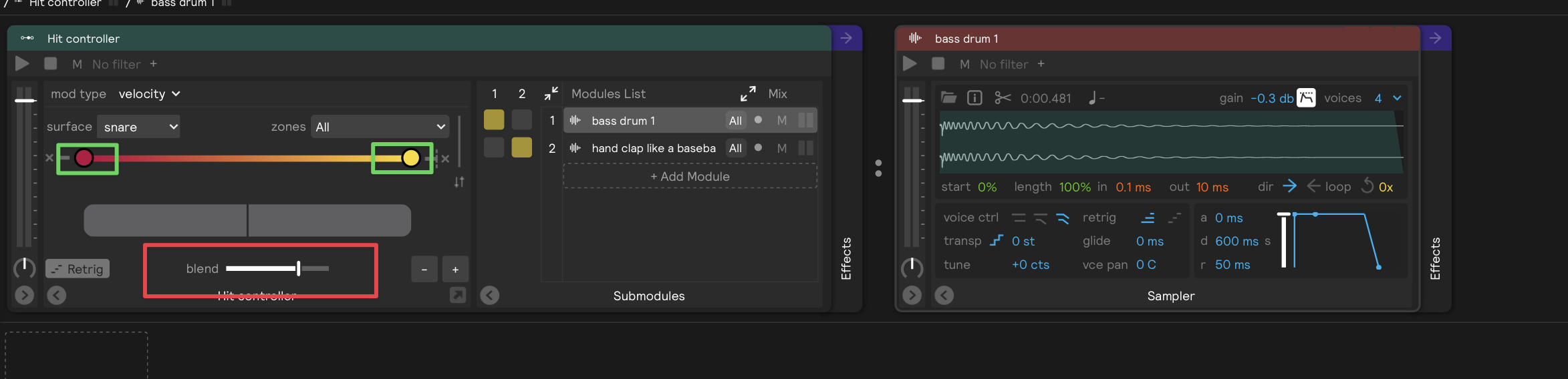

trying to figure out how to make this DnB/Jungle Kit on the sensors…specifically the moment he talks about the x fade or velocity to open up more of the snare sampled sound…so the harder he hits the more it opens up and the ghost notes stay as the snare

Hi @ORBKA, sorry I missed this. You can accomplish this with the blend parameter of a hit controller in its default “velocity” mode:
The blend parameter is outlined in red in the image above, and you can also experiment with adjusting the sensitivity of the hit controller (outlined in green above).
