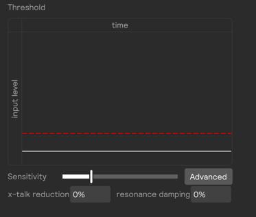

This release also includes some new parameters for the snare that can help with cross-talk from the hi-hat. If you open the training panel on the snare, you’ll see a new “Advanced” button next to the sensitivity slider. Please give those two new parameters a try and let me know if they make any difference for you.
