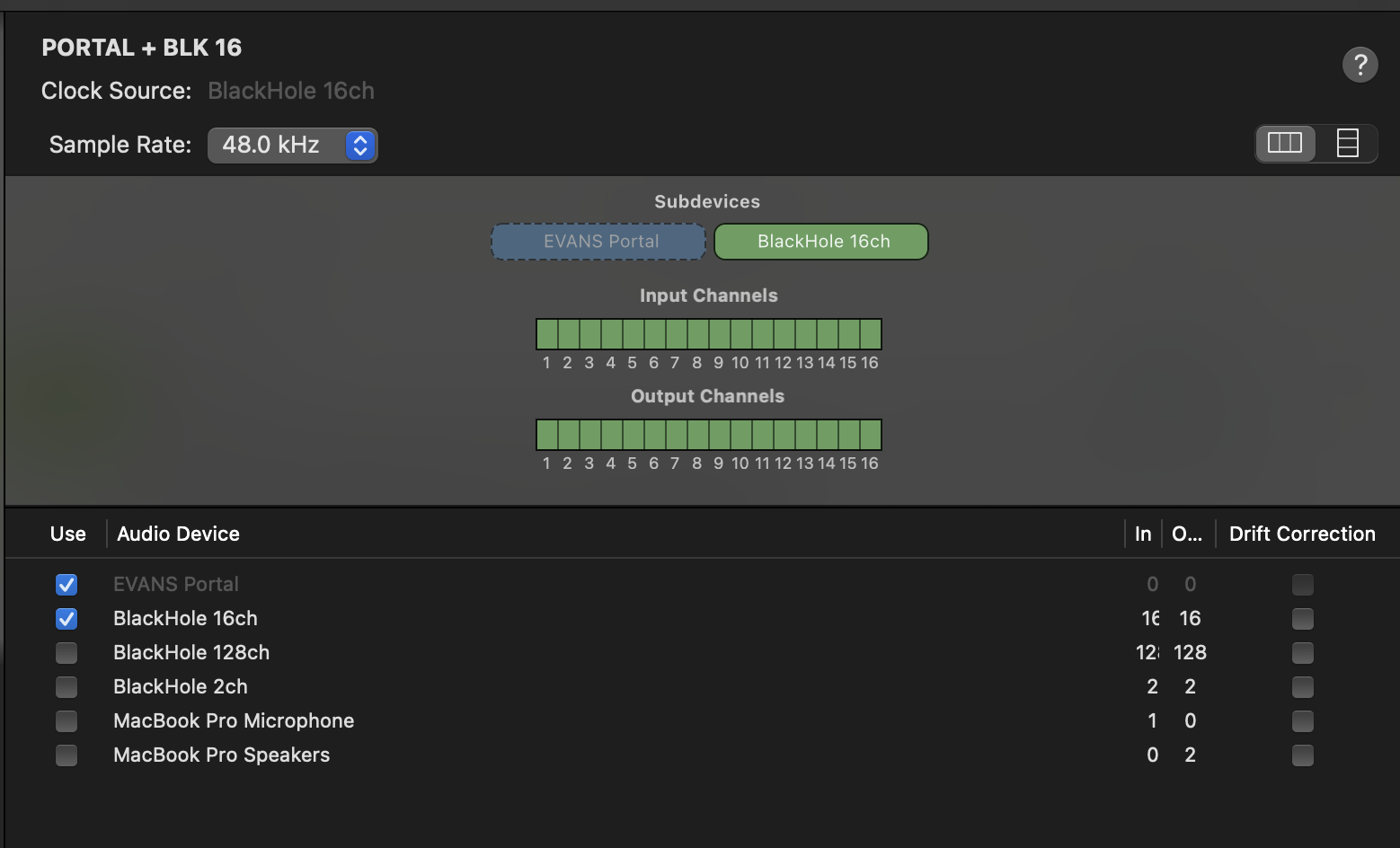

So I created an aggregate device that combines portal and Blackhole 16. I had to do this because in the SP software I use both the portal’s hardware outputs for routing sound to external pedals, and am using Blackhole to send audio to Ableton. To create an aggregate device you choose the + sign at bottom left of the audio midi setup page.You could do it with Blackhole only if you are simply sending sound to Ableton.
This is what my aggregate device looks like.

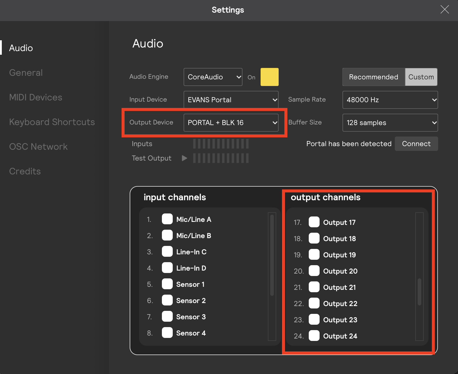

In the Sensory Percussion software, you would go to the settings, and choose Blackhole (or your aggregate device) as the output. Don’t forget to activate the outputs. (My Blackhole starts at output 17 because I set it up that way in the audio midi set up. First 16 channels are the actual portal interface outputs).

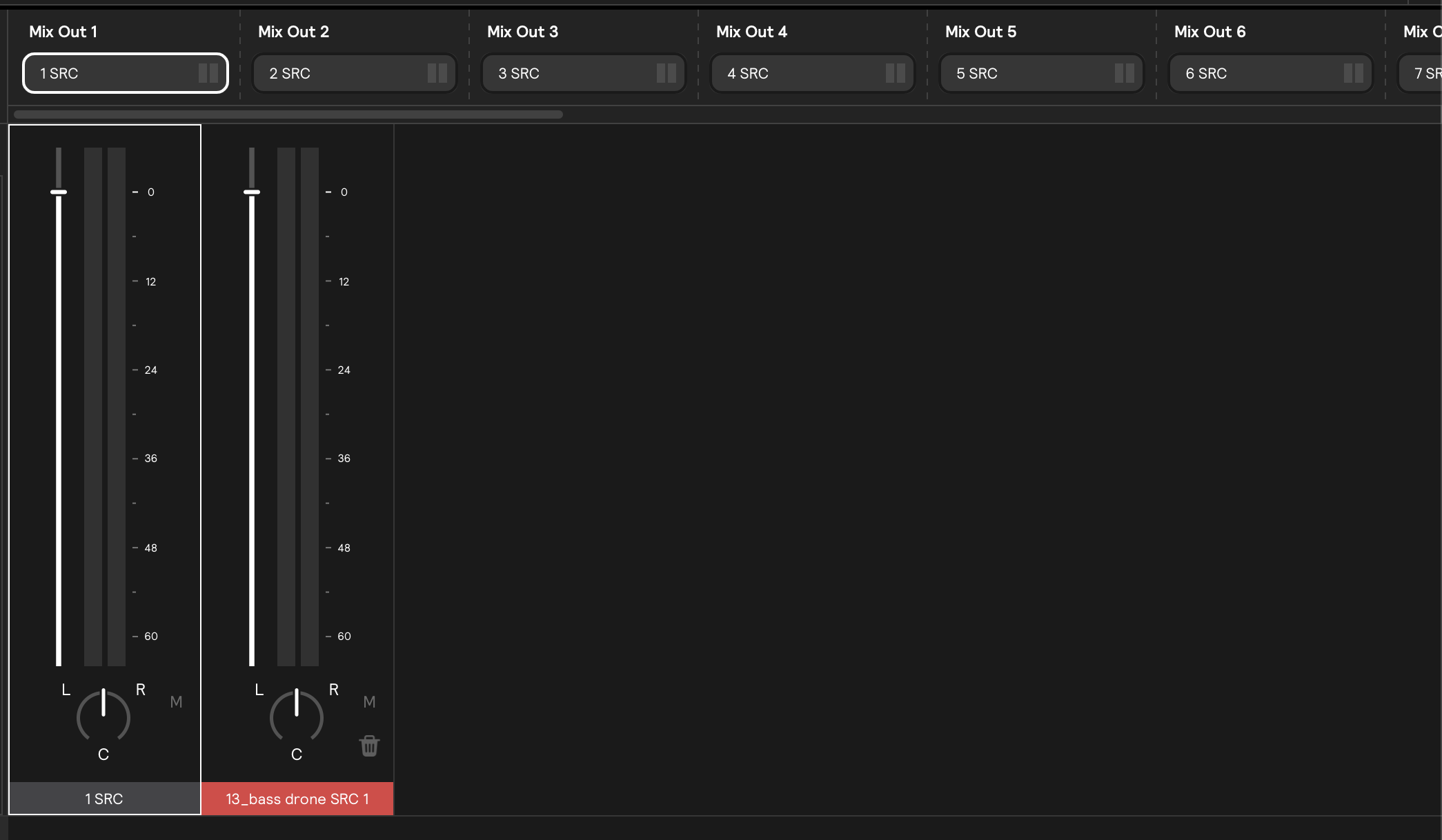

Now in the MIX section you can drag whatever sound source you want into the different buses, which will guide them to the different Blackhole channels. (that you just set up)

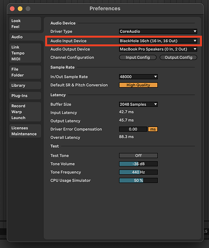

In Ableton, go into the audio settings. Choose blackhole as the input.

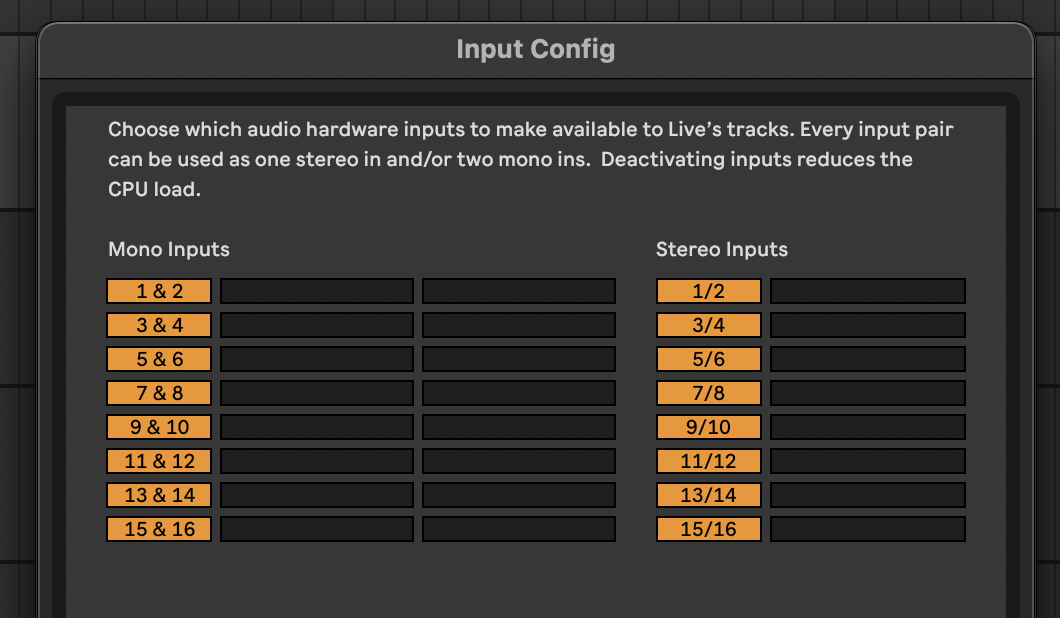

Dont forget to activate the channels.
Now all you have to do is create tracks and select the channels that sound is coming through.
