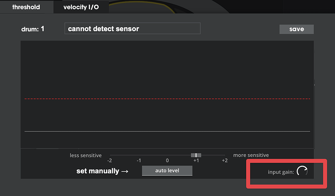

If I remember correctly, you’ll probably want to increase the gain of the V2 sensor a little bit in the threshold panel, as well:
