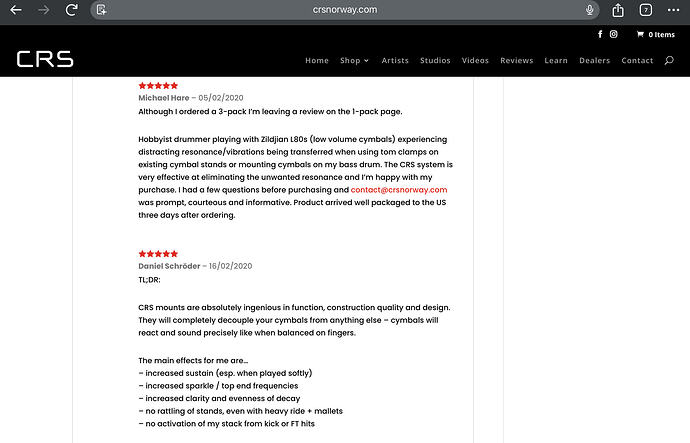

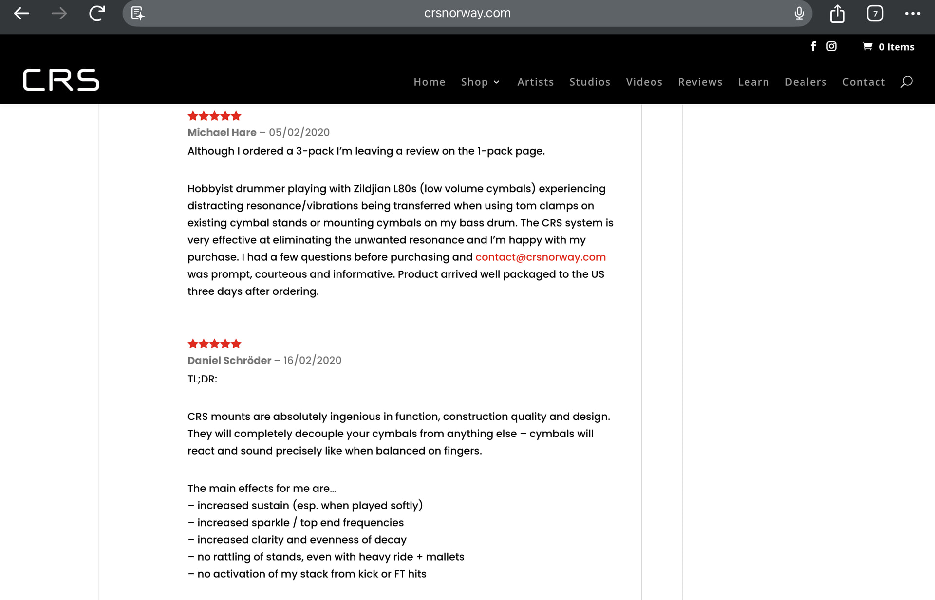

Funny, I have actually tuned the drums up a bit and it seems to have made it a little better. :laughing: Otherwise I’m also around 75% and I also still get the occasional hiccup there. After some research I found the CRS Cymbald Resonance System (www.crsnorway.com) which seems like an awesome idea and I felt like trying those (with real cymbals as well as my SP-Set). I’ll let you know if that makes a difference once I have them here…
e23, thank you for sharing information about this product. I am reading some of these reviews and they are speaking directly to some of the issues we have been talking about. I am intrigued!
I have finally tested the CRS.
First things first: I was able to eliminate most of my crosstalk issue in software before I even got them, so they weren’t really needed but I wanted to try them anyway.
Bad news: It does not fix my crosstalk issue. I was able to turn crosstalk detection down from 80 to 70 … maybe. But that could also just be margin of error.
Good news: It does decouple the cymbals very effectively, so those short vibrations that you can hear and feel when you hit the cymbals, like a short and low metallic hum in the hardware and the floor, those are gone. I will keep them for that alone. It just doesn’t fix my crosstalk issue.
