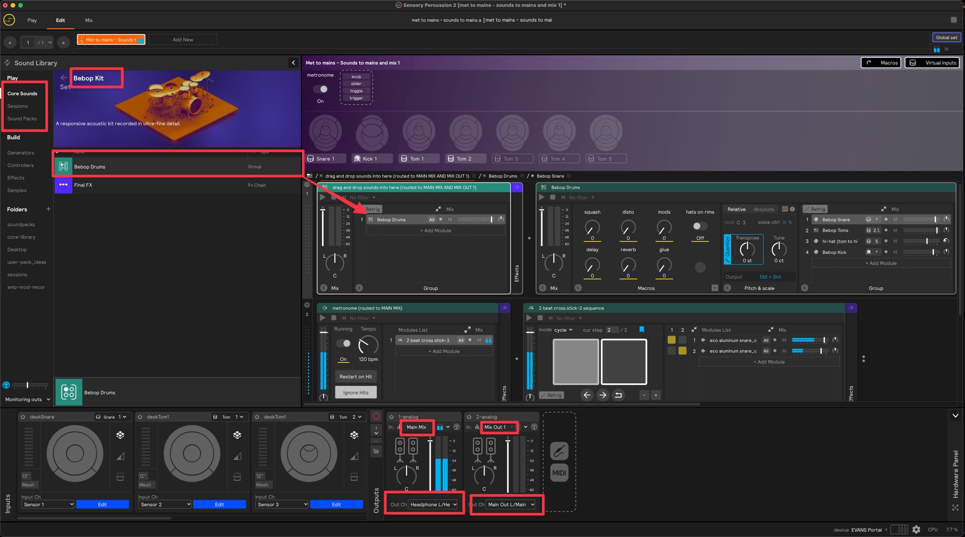

I threw together a template where you can drag and drop kits (and any sounds, really) into the top level group and that will be routed to Mix Out 1 and Main Mix. And then there’s also a metronome routed to Main Mix.
So, with this template you just need to have your headphone outputs receiving the Main Mix, and your main outputs receiving Mix Out 1 as in the screenshot below:
Here’s the template:
met to mains - sounds to mains and mix 1.sp2 (5.0 KB)
