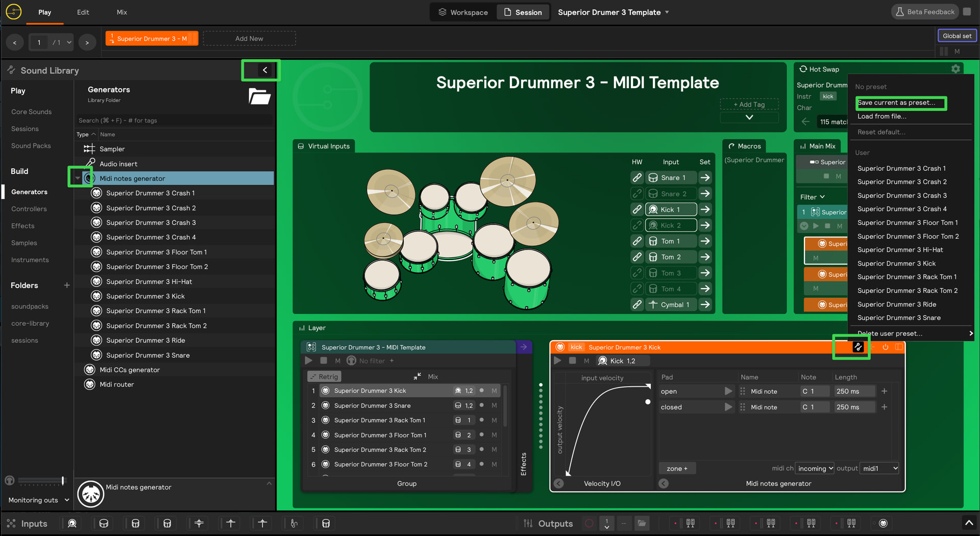

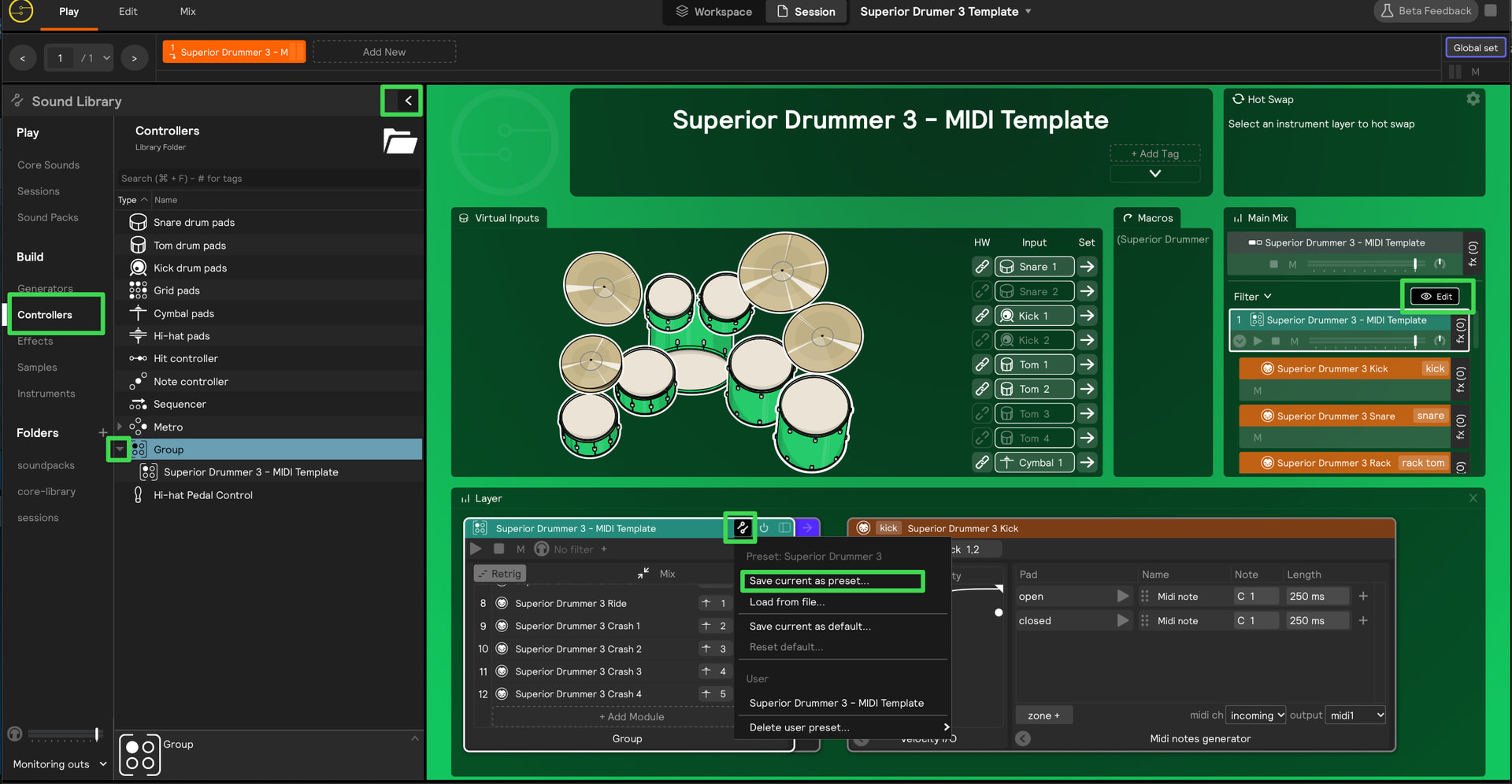

  2. Recommended: save the group in template as a preset, so that you can access it from the library - it’s a “Group” module, so it will show up under Controller/Group. You can save each drum/cymbal as a preset, as well, those will show up in the library under Generators/MIDI Notes Generator

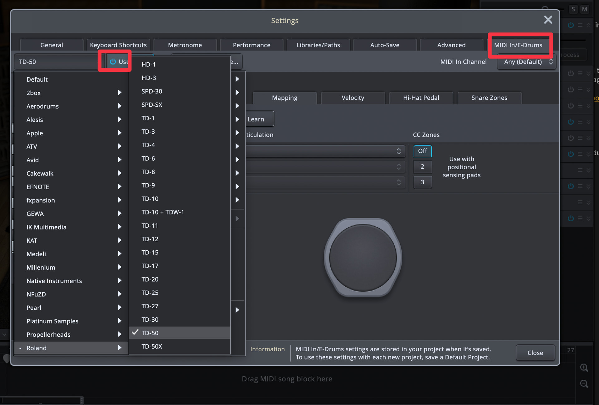

  1. Important: In Superior Drummer, select Roland TD-50 in Settings/MIDI In/Edrum/Use Preset
  1. Setup your MIDI as you normally would: MIDI Out | How To Set up a Virtual MIDI Bus | MIDI Outputs.

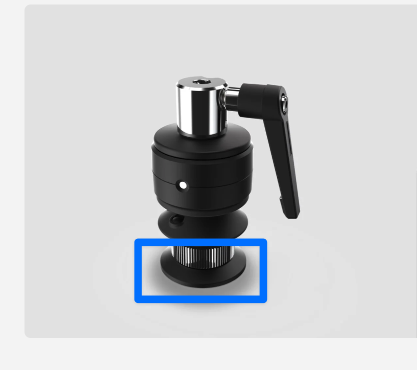

@scoTTTimo,
For the hi-hat sensor, make sure the metal nut clamping the hi-hat sensor to the cymbal is nice and tight:
And then yes, definitely compare the presets in the Cymbal and PGB expansion packs with the results you are getting by sending MIDI to SD3.

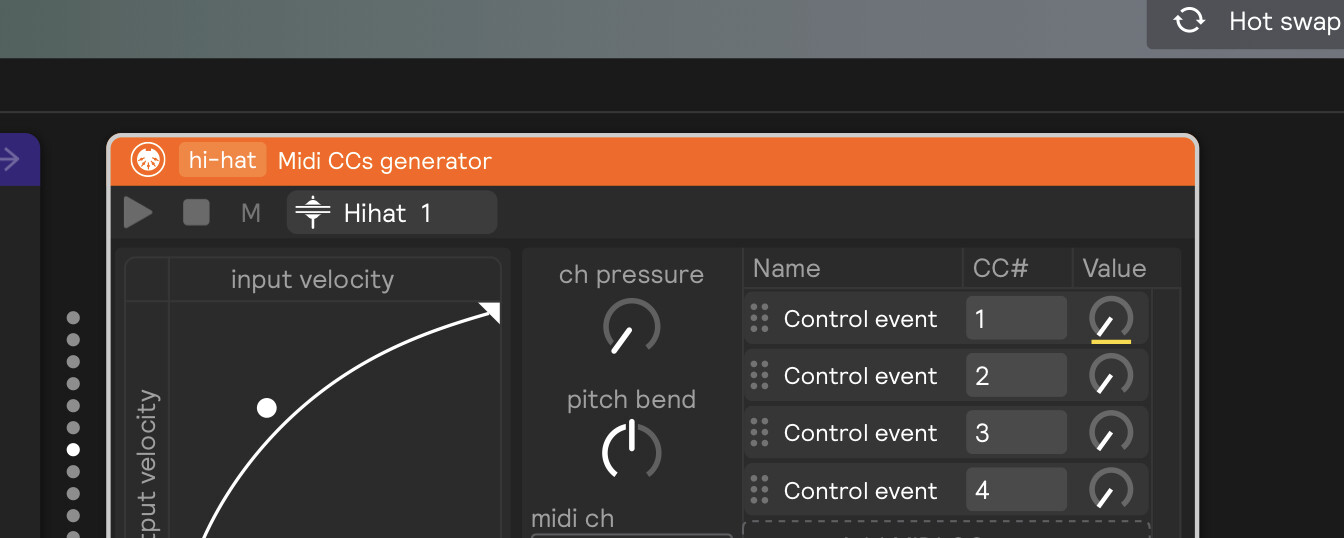

I see the template doesn’t have a hi-hat pedal controller, isn’t that necessary for the hihat to send the pedal position?
@edxter,
The Hi-Hat Pedal Controller is an important ingredient in the sound engine that powers the multi-sampled hi-hat instruments in the Sunhouse Library, but it has more going on than just sending pedal tension values, and it is not ideal for sending MIDI.
The pedal tension value in the template is sent with a special Hi-Hat assignment type called pedal, and that is mapped to CC1, which SD3 conveniently accepts automatically as pedal tension.
@stevenz Tightening the nut definitely helped. It’s much better in SD3 now, but still not amazing. I would agree with you that it’s “not bad”. It’s not perfect in SP2 either though. I can get it to mistrigger pretty easily. I’m used to the Roland digital hi hats though :slight_smile:

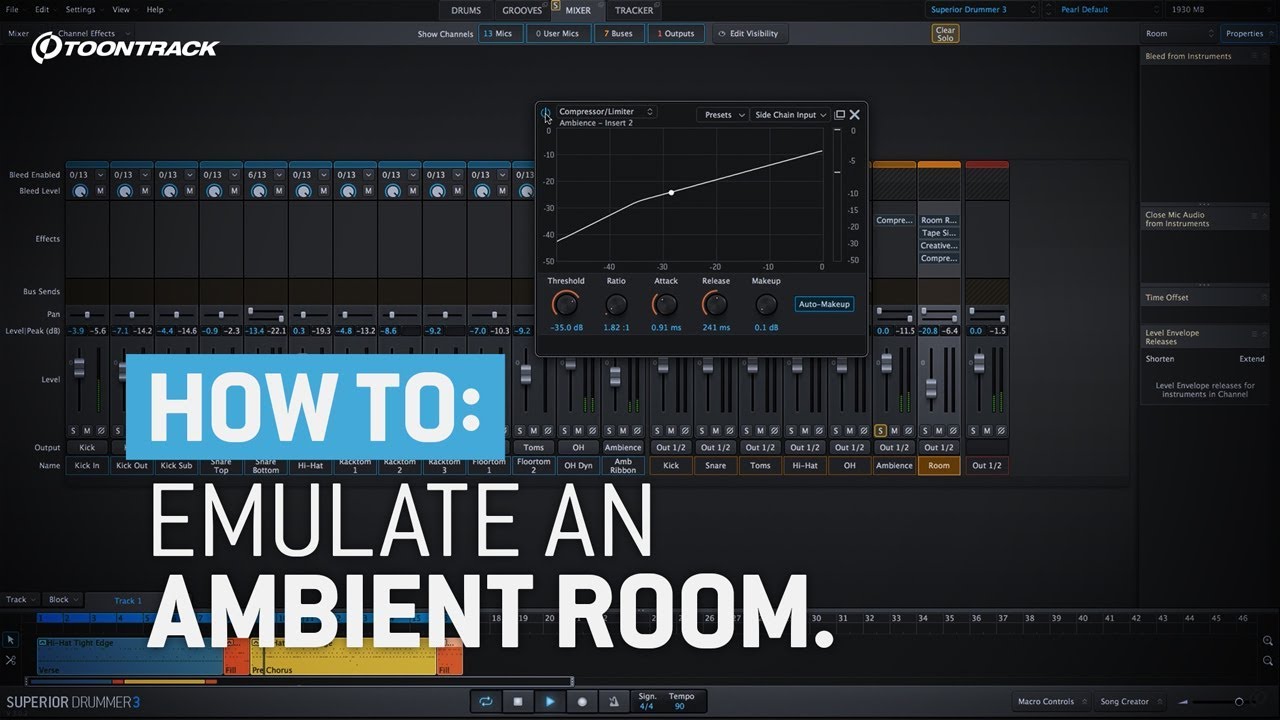

Have you tried playing around with either a room modeler or triggering ONLY the tails from SD3 to give a further away sound on the SP2 sounds? I haven’t tried that on cymbals cause mine are still on the UPS truck but I’ve done that with their drum sounds to a lot of success.
I could go into detail of how to only sample the “room” sound on SD3 but there’s several youtube tutorials already. Lemme find one and link it here
I can’t find the exact video I used for my template, but within Superior Drummer you can either load up a killer room, or use this video to create a room mic channel with effects. After that, you adjust the ADSR so that SD3 is only triggering the tails of its samples, you want zero transient. Then you can combine that with the close mic audio from another source to create a “fake” room noise

@scoTTTimo,
Glad to hear it’s working somewhat better now after tightening the bottom thumbscrew. Here’s a recent post by @tenoch going further into some setup best practices that may help further: Troubleshooting Cymbal & Hi-hat issues

For the cymbal chokes you could let us assign the ‘
channel pressure’ already present on the midi cc generator to the cymbal notes. SD3 expects just that for cymbal chokes.
